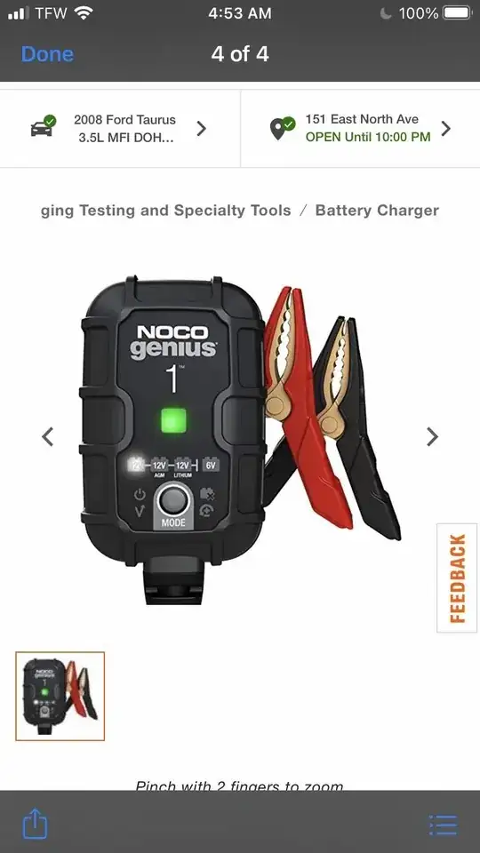

My car battery died last Monday and it’s been a week; I’m trying to get it to charge using a noco genius portable battery charger but nothing comes on in my car, no sound lights or anything. Will I have to wait 24 hrs for it to fully charge or will I need a new battery? Bought it from auto zone. enter image description here GENIUS1 SKU # 606157

Most battery chargers today are smart enough to not apply a charge to something which it doesn't see as a 12v battery. If the voltage on the battery is too low, this may be what's at issue. The reason for this is safety so you aren't trying to charge a 9v battery to 12v, which would cause issues to the battery as well as could cause problems with the charger.
To overcome this, I will put a good 12v source battery in parallel with my weakened battery to provide that source voltage the charger needs. I have several small 12v batteries which I've changed out from different sources (ie: garage door opener battery backup) sitting around for just this purpose. Once attached to the battery to be recharged, the charger will see the 12v source and charge it along with the weak battery. Once both batteries are up to par, the charger will go into maintenance mode. I have found this method works well for charging depleted AGM batteries as well.

2-Your charger is only outputting 1 amp according to specs found online, basically a trickle charger that's mainly used for topping off a partially discharged battery and can be left permanently connected for long term battery storage without overcharging it. To use it for charging a dead battery may require minimum of 24 hrs or more. Battery chargers outputting 10-20 amps then drop output automatically are more suited for recharging a dead battery. With an Autozone battery tested as sound, you may be able to ask them to recharge it and return later in the day or next day. Call ahead and ask. If your dead battery is discharged below 10 volts, your low amperage charger simply takes longer and may not even charge.
