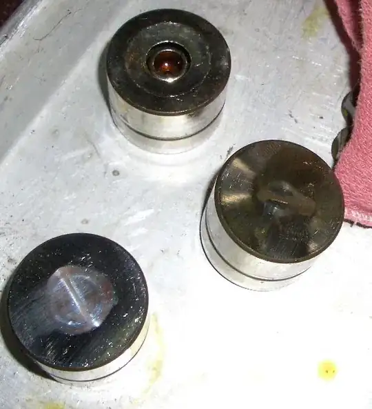

Around 5 years ago my '97 Audi, which I had run from the first oil change with Mobile-1, had 2 of the lifters go quite badly, in what I'd consider a lubrication-related failure. Here is a picture:
Failed lifters from my Audi
Now, maybe this was a design problem, but I haven't heard of it being common on these engines. SO my take on it is that, in my admittedly small sample size, the only lubrication-related failure I've ever had has been on the car I ran Mobil-1 in from the first oil change.
So, I won't run Mobil-1 in my cars, and I'm mostly skeptical of it's competitors.
