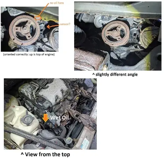

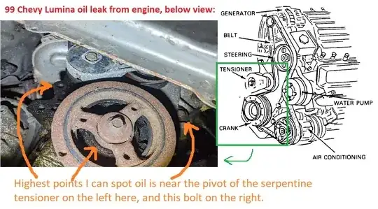

Shows passenger side of engine from below, with serpentine crank and tensioner, showing the highest point I have found oil
Lots of oil dripping from the passenger side of the engine. Best I can tell, the highest point I can see wet oil is near the pivot for the serpentine tensioner, but I also see oil a bit forward of that, near some bolts and what looks like a sensor (the orange arrow on the right side of my picture). Above the crank pully (I think) it looks dry / no oil.
Any ideas for common leak culprits in this area?
A few more pictures: A few more angles showing the highest point oil is visible

Thanks all! It turns out I'm dumb, it's transmission fluid leaking from a line going to the oil cooler and then splashing everywhere. Cheers!
