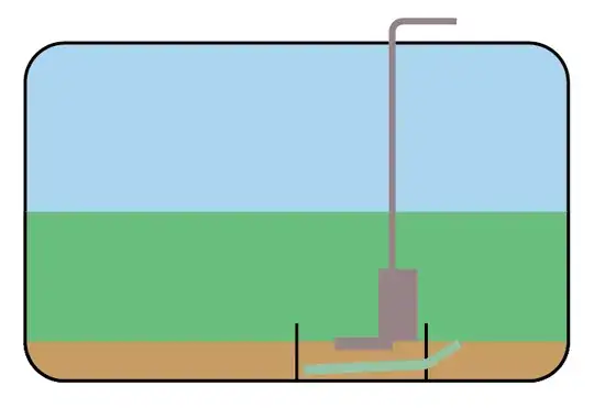

You can't get better MPG with a full tank. The engine simply cannot use gaseous fuel. It must be liquid or the injectors cannot correctly meter.
The top half is larger due to "Unusable Fuel"
Open up a modern fuel tank and you'll find an electric pump in there. It creates high-pressure fuel (300 KPA/45 PSI or so) to supply the fuel injectors. You'll also find some funny baffles around the pump inlet. These make it impossible to use the very last fuel in the tank. This is, in aviation terms, "Unusable Fuel".
That does a couple of things for you: it keeps crud and (heavier) water out of your fuel injectors and pump. The pump needs fuel to cool and lubricate; it'll be destroyed running dry so it makes sure there is fuel for that.
In this illustration, the green/blue border is the true 50% mark on the tank. But the brown (unusable) area impinges on the green (bottom half) area, making the upper half larger.
Of course, a real tank's shape will also be irregular due to needing to clear vehicle components. The empty/full gauge isn't sophisticated enough to account for these variations (or parking slope)... so on some cars that too will affect things.
They generally aim to have "E" be at the "unusuable fuel" line. There's a little bit of margin on unusable fuel due to splash and slosh: fuel can sometimes get over the baffles to a degree.
