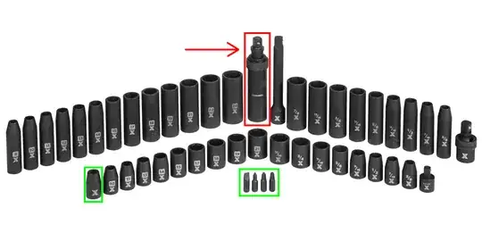

impact socket set with manual impact driver Manual/hand impact drivers are usually described for use with impact (screwdriver) bits. But can they be used with hex sockets too?
I realize that typically an electric or air impact driver/wrench would be used for sockets, but it would be good to know if the manual driver can also be used in a pinch.
Is it ok, is the manual impact driver simply not able to deliver enough torque, or is it even likely to be damaged by such use?

Yes, and they can work well.
Often got me out of a situation long ago before all these cordless things appeared and I was out in a remote field.
And a large hammer tends to make them work - as long as the piece that the nut, or bolt, is on does not deform...
However, I also found that using a bar and alternately trying to tighten then loosen the nut or bolt would work as well.
