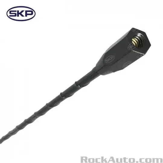

While if you used a CB antenna, it might work ... it wouldn't work very well. If you look at an OEM antenna for your truck, you'll see it has not only the central core (sort of like a CB antenna), it also has a separate wire wrapped around this core. You can see it in this image:
Without this secondary wrapping, the whip portion won't work near as well as stock. My suggestion is to follow your mechanics recommendations.

In the image above from Paulster2, the wire wrapped around the antenna is a vortex shedding device. Without it, the antenna will shake, vibrate and generally destroy itself, especially when it gets wet (personal experience.)

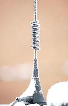

Antennae that have a spiral coil at the base indicates that the antenna has been designed and tuned to provide for frequencies that would otherwise require a much taller/longer antenna shaft: photo from above linked site.
coil tuned antenna
