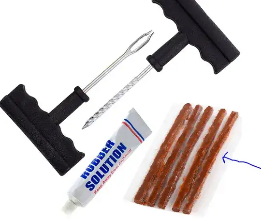

One of these rubber sticks. Pushed to far and dropped into the tire. Was able to patch the tire properly with a second stick. How bad is this? Weighs less than the screw that was stuck in my tire.

You are correct - the weight of that plug is insufficient to cause any measurable disbalance and too soft (and too light) to cause any mechanical damage on the inside. I wouldn't worry about it.
