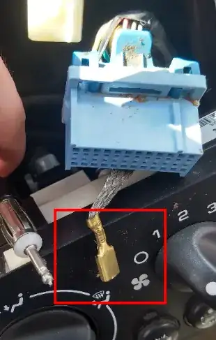

Picture of wire:
silver braided wire with gold connector

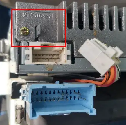

The gold connector slides over this tab:
small metal tab on back of car radio
Any ideas as to what this wire is? And do I need to look for a radio that has that particular attachment, or can I safely ignore it?
It is a chassis ground strap. It electrically bonds the case of the radio to the body of the vehicle. It reduces the posibility of static electricity damage and electromagnetic interference from other electronics in the car. It is a good idea to connect it. It also helps improve radio reception because it part of the antenna system.
