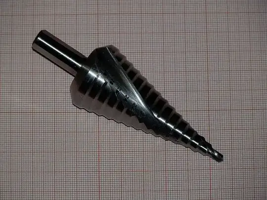

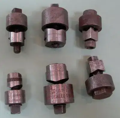

To make a clean hole in sheet metal, use a step drill bit. Put a dab of oil on the drill bit and keep the speed down. To make a hole larger than your largest step drill bit, first make a hole with your step drill bit, then use a chassis punch, which requires access to both sides of the sheet metal.
Step drill bit Step drill bit
Chassis punches
Chassis punches
