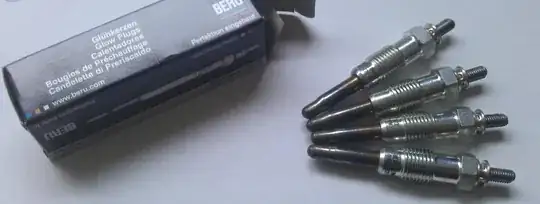

Is the color of the heated part normal for 4 glow plugs that are brand new ... ?
jzd
  • 3,615
  • 24
  • 35
Skippy Fastol
  • 473
  • 19
Yes, depending on the specific glow plug, this coloring is normal.
Here is a link to a new BERU plug that has the same coloring in the image:
http://www.autopartswarehouse.com/sku/Beru/Glow_Plug/W0133-1631189.html
Here is a nice shot of a used glow plug:
used plug
jzd
  • 3,615
  • 24
  • 35
Be careful if you decide to 'test' your new glow plugs.
The lot of glow plugs start off with 12 volts, but then after 2 seconds the voltage is dropped by their ECU to 4 volts operating voltage. If you keep a supply of 12 volts to the glow plug they will burn out and become useless.
