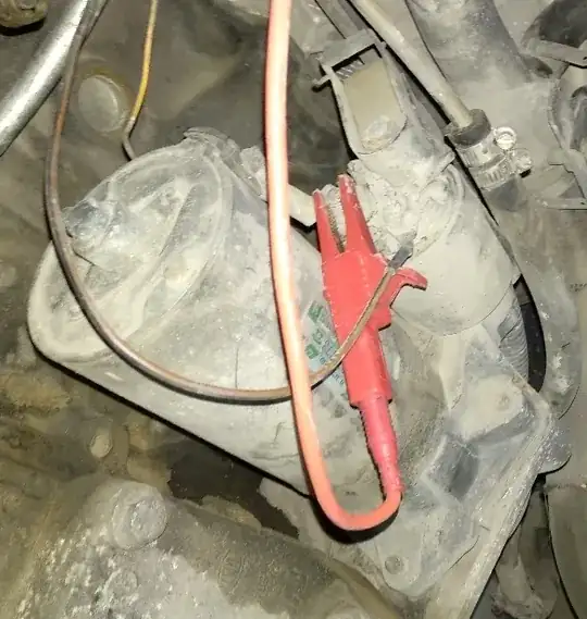

  • 10.5 volts measured at starter solenoid when grounding to engine block

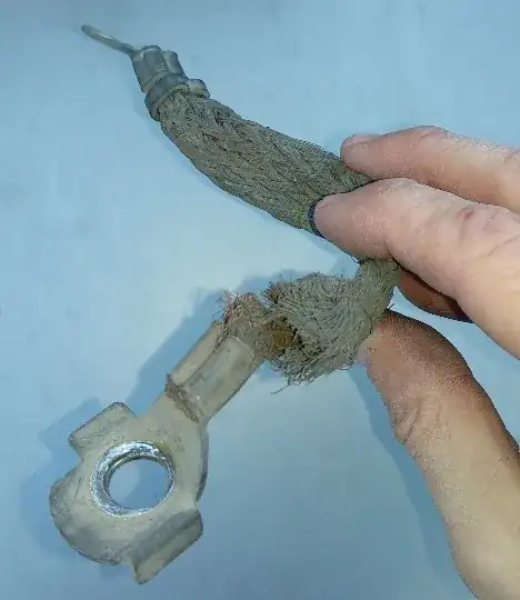

Ground strap was clearly bad so I replaced it and retested.

  • 11.13 Volts at starter solenoid when grounding to engine block
  • Vdrop from B+ to the starter solenoid of 1.3 volts
Clearly the starter solenoid is not closing since if it was the amperage draw would be way higher. It seems clear that the voltage drop between B+ and the positive solenoid terminal is way too high, but is it high enough to prevent the solenoid from engaging? If it is, could it be that the security system switches in a resistor? The Ituran customer service says their remote diagnostics say the system is working correctly.

Here are some pictures of the old ground strap
and where I'm connecting to measure at the solenoid:

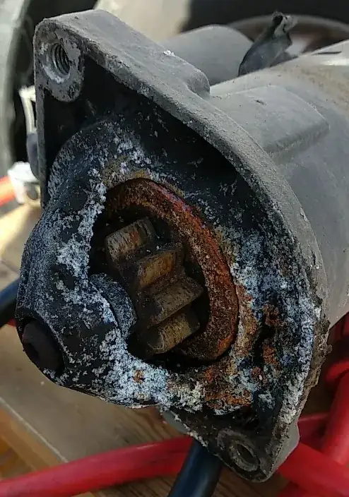

OK, so this turned in an unexpected direction - when I loosened the bolts of the starter some water started running out I when I completely removed it I found this:
Somehow water got into the starter area and the pinion rusted in the extended position. That of course explains why I couldn't hear or feel the solenoid engaging. I took it in to bench test it and it wouldn't move and I got the same readings. It must have been that the solenoid was moving just a tiny bit - enough to make poor partial contact across the terminals.
So I bypassed the solenoid and connected power directly to the motor which was enough to break it free and get it running. Then hooked back up to the solenoid, and it was able to extend and retract the pinion, but I was still getting a voltage drop across the solenoid terminals. So I removed the solenoid, cleaned around it's base where it attaches to the starter body, removed the nuts from the terminals and wiggled things around a bit then put it all back together and walla - no more voltage drop. Spent some time running it on the bench to loosen things up as much as possible, cleaned the mating surface on the starter and the engine with a wire brush, reinstalled and the truck started right up!
Seems what looked like a bad solenoid was a purely mechanical problem...
