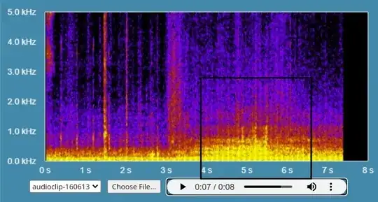

I also recorded the sound and inspected it with spectrogram. Here is the audio https://sndup.net/3zt2. It starts at 4s.

  • It does not "knock" immediately after I press gas pedal. and even in the recording or the spectrogram above it is apparent, that the revs first built up to around 2500RPM and then it started knocking - it does not start knocking after I press gas pedal immediately
  • You can hear multiple "bangs" in one "knock". It is most apparent in the second knock. The first "bang" is quiet and not much noticeable. You can also see it in the spectrogram.

After I thought long about it, It does not sound like a premature detonation. It is a metallic noise and even the frequency does not indicate the LSPI. It would have to be much more frequent. The weird part of it is the stable frequency of the knocks.
