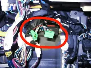

There's an electrical connector under the dash of my 2000 Subaru Forester that is apparently instrumental in the diagnosis of some OBD-II trouble codes. It's a pair of bladed terminals like any other on the car:

The test connectors are common on Subaru vehicles. They put the car is diagnostic mode and allow for things like the ECU to be reprogrammed. I actually have a Saabaru and had to connect these to use a Cobb Accessport. While it was connected I also had fans and other items turning on and off randomly.
Would need some context for the instructions in the manual as to explain which drain valve, but that should be a separate step.
