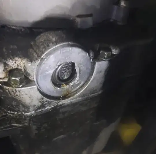

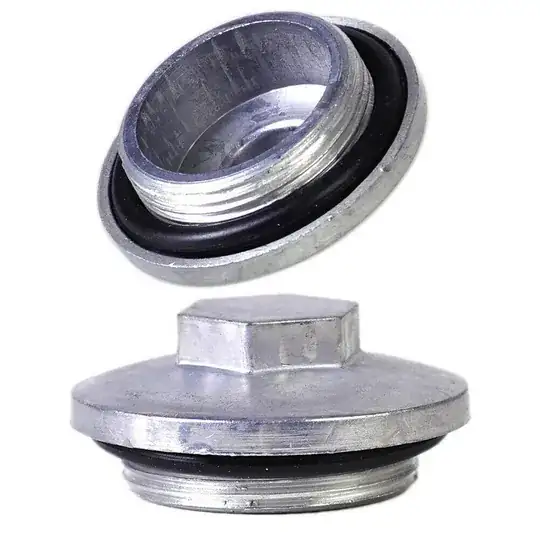

So I have this broken oil drain cover under my GY6 Chinese Scooter
Broken oil drain cover
I'm pretty sure it's one of these:
The head was rounded and I thought it was just a steel bolt that went through a cover so I put some more pressure on it and tried to force it to twist off, but that just broke the part on the top that looked like a bolt. Then I realized it's just 1 piece and probably aluminum because it's pretty soft.
The spring and the mesh that you can see are pretty soft so I can push them in a little, and when I buy the new set I can get a new spring and mesh, so it's not a big deal if I damage them.
But how can I get this off?
Is there something I can put in the hole that can apply force outward and then twist?
Or how about using a small saw to carefully cut the sides of the ring and then pulling broken parts out piece by piece? If the main body under it is steel will it be strong enough to survive this?
Otherwise, how can I fix it?
The full set

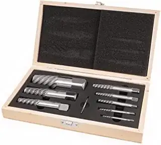

One is called a Jumbo Screw Extractor, routinely available up to 1.0625" and larger sizes are available. Here's a link for an inexpensive set.

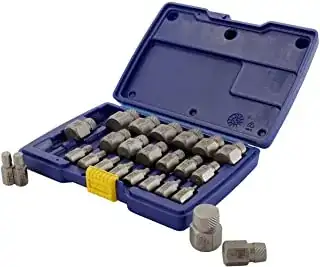

One is called a Multi-Spline Extractor. Kits for up to 7/8" holes are routinely available and larger sizes can be obtained. Here's a link to the Irwin kit on amazon

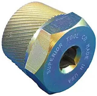

Another is called a Tub Drain Extractor. These may be found in different sizes, but 1.5" is typical. Here is a link to a heavily tapered one from Husky and here's a less tapered one from Superior tool.

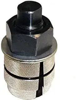

Another one is called a Drain Key. It expands inside a drain, locks in place, and then allows you to rotate the whole thing. Here is a link to one from Superior Tool.

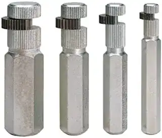

The last one is called an Internal Pipe Wrench. It expands when rotated counter-clockwise and collapses when rotated clockwise. Here's a link to one from General Tools.
Below are some images of the various options.

Jumbo screw extractors
Internal Pipe Wrenches
Locking Drain Key
Tub Drain Extractor
Drain Removal Tool
