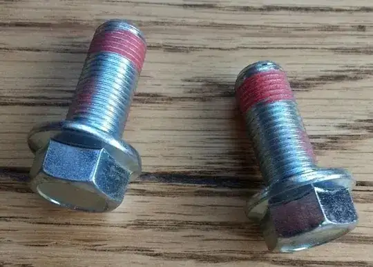

I'm replacing some broken bolts in my front Subaru brakes. Specifically these are the 17mm bolts which attach the caliper bracket to the hub / knuckle assembly. The calipers separately attach to those brackets.
I ordered these parts from Autozone as they are specifically supposed to be matching replacements for my vehicle. But I was surprised they had no markings about bolt grade. Since these are the front brakes I don't want to take any chances with using the wrong part or a sub-standard part and thought I should check if this seems fishy or OK to use.

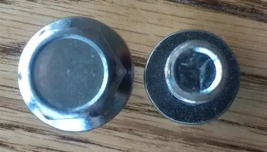

Its a little hard to make out in the photo but there is a semi-triangular marking on the tip of the bolts but I don't think this is the same as a grade marking that would normally be on the head.

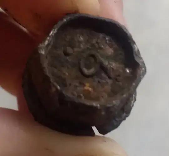

Photos of packaging & bolts - the last one is the original bolt, marked with a 6:

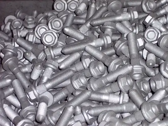

A good sign (among others) would be a matte gray coating, like this:
enter image description here Von Erikviking, CC BY-SA 3.0, https://commons.wikimedia.org/w/index.php?curid=8994272
This is zinc flake coating, a good method for bolts with grade 10.9 or above.
