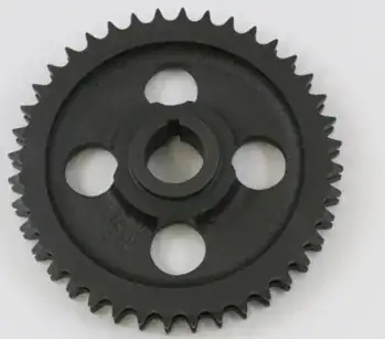

A camshaft can only be attacked to the camshaft sprocket in 1 orientation which you can see when you look at the camshaft sprocket. (See below image for an example)
Camshaft sprocket
It is important to know the position of the camshaft relative to the crankshaft, so the timing is correct.
