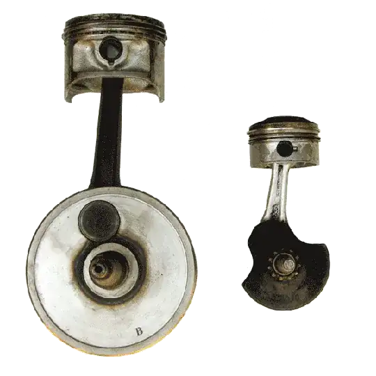

Torque in a motorcycle enter image description here
The piston moves up and down, and the force for that comes from the fuel that is burned. Connected to the piston is a rod, the connecting rod, and that rod is connected (with the ability to turn) to the crankshaft.
The distance between the pedal to the rotation point is comparable to the distance between the crank and the middle point of the crankshaft, and in the same way as in the bicycle example, the distance "counts" for 100% when the point of the crank that is connected to the rod has an angle of 90 degrees with the direction of the piston, and for 0% when that point is in the highest or the lowest position.
Maximum torque A piston, therefore, delivers a varying amount of torque. The torque at a certain rpm is the average torque that the piston delivers during the revolution stroke. And when your motorcycle has more than one cylinder, the torque of the individual pistons add up.
The rpm where the maximum torque is delivered, is the rpm where the fuel is burned most efficiently: it is at that rpm that the piston delivers the maximum torque on the crank.
