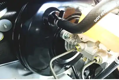

You didn't mention the car make and model, but I'm assuming your car uses a vacuum powered brake booster. (See below image) It uses vacuum power from the engine to multiply the force applied to the brake pedal. If the brake booster fails or if there is a vacuum leak, it will not work properly, resulting in a hard brake pedal.
The brake booster (black), the brake master cylinder (silver) with two brake lines and a vacuum hose from the engine providing vacuum pressure.

But again, I'm pretty sure the issue is caused by a vacuum leak. The brake booster gets vacuum pressure from the engine intake. Whichever part is leaking must be replaced.
