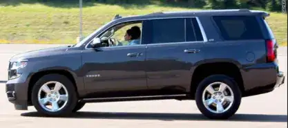

Last week I was driving a motorcycle. When I stopped at a traffic light I noticed the rear suspension dropped a little when I released the rear brake. Later I noticed my car did the same thing. When you suddenly stop, but not release the brake the suspension appears to be locked ("frozen") (See below image). When you do release the brake, the cars suspension appears to drop down to its resting position.
Suspension position when braking
But why is this? As far as I know parts of the brakes (brake rotors, calipers, drums and shoes) are not connected to the moving suspension parts such as the damper spring, damper and stabilizer. Also the suspension does not require the wheels to move in order to move. You can just as easily bounce the suspension while the car is parked.
Can someone explain to me how this works?

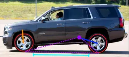

I made a crude sketch illustrating the relevant points of the shown image.
Brakes engaged:
The center of gravity is above ground, the brakes "try" to slow down the car, the car itself "wants" to move further forward. The front "sinks", compressing the front struts (orange). The rear "raises", thereby allowing the rear suspension (blue) to "open".
As a consequence the distance between front and rear wheels (red) gets smaller (teal line).
When the car is now at a complete stop:
The applied brakes keep the wheels from turning, thereby the distance between the wheels remains the same.
This is now important: The contact points of the wheels, combined with the pivot (purple circle) of the rear suspension form a triangle (purple lines). A triangle with fixed lengths allows no movement.
Thereby the rear stays raised. The front wheels have only a small effect as they have a pure vertical freedom, excluding every horizontal movement.
Brakes released
The relaxed brakes allow the wheels to roll freely. The "blocking" triangle now gets "deactivated" as the distance between the wheels is now variable. The now opened wheels allow the rear suspension (blue lever) to "close" as the rear of car still weights down on the rear wheels through the springs.
