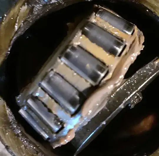

Outer bearing (smaller)
The roller surface has a gray stripe in the middle, but the grease looks completely healthy. It looks tan because it was shot under HPS lights. The inner race looks OK.

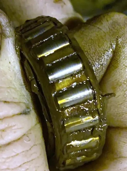

Inner bearing (larger)
The roller surface seems ok, the outer race looks fine, but the grease looks filthy and muddy. Again, brand new grease. It's all over the bearing like the bearing is causing it, but could it be something else like water ingress from a failing lip seal? What's wrong with it?

Edit: It turns out I was looking at the wrong side. On the left side, I found the nut much looser than I had set it. It had a muddy inner bearing (from an ancient lip seal leaking; replaced) and a weirdly dirty outer bearing. (my grease is Red Line, literally red, so I can instantly spot dirty grease). I dunked the inner bearing in solvent for cleaning, fished it out with my finger and repacked it. Dunked the outer bearing, fished it out with my finger, repacked it. Put it on, it was weirdly grindey with inner bearing installed. .
So I got another bearing from a junkyard pull, test fitted it and it ran smooth as glass. I dunked it in the same solvent, and fished it out with a screwdriver this time. The screwdriver came back covered in metal shavings. I could not believe so much metal shavings could come out of one bearing. Wait. Did this metal come from the original bearing or the junkyard pull? Then I cleaned the solvent, re-dunked the junkyard bearing until no more metal shavings appeared. Repacked it, put it on the car, smooth as glass.
Now I've re-solvent-washed the original outer bearing, a little more metal shaving showed up (a-ha!!!!) Clean/dry/in my bare hands it runs VERY lumpy with a little pressure. It didn't look all that bad on the rollers and races.
So I think that was my problem. Yay, I'm about to do a 3000 mile cruise!
Both bearings show a wear strip - this is normal.
The grease that is milky or grey has been contaminated and needs replacing.
On my 4*4 I used to clean and repack the bearings then set the play very carefully. They lasted for years with no problems with exactly that middle strip wear pattern.
Inspect carefully - any chips or cracks on the rollers means time for replacement.

Not sure how either blacksmith or Mike came to their conclusions ... you cannot tell much about a bearing until the grease is removed. Grease will tell some of the tale, but it has to be cleaned for the bearing to give you the full story. Then you can look for discoloration in the bearing (blueing due to heat) and also run your fingernail across the roller surface and detached race to see how much scoring is actually there. If your fingernail catches at all, then it's time for replacement (or blueing is present as I already stated).
From what I can see there isn't any issues with the bearings, but really they need to be thoroughly cleaned, inspected, if no issues found, repacked, and then put back into operations. If issues are found, then you would replace.
Pᴀᴜʟsᴛᴇʀ2
  • 165,084
  • 32
  • 259
  • 508
Both bearings are gone. The tan grease looks more like water emulsified into the grease. One thing that causes a grey/cloudy is abrasion / dirt in the bearing. Maybe it is corrosion, would fit with water in the grease . Electric discharge can cause a "frosted" surface , but I doubt that is the problem. I would replace them and the seals and see if that fixes the situation. A good rolling element bearing should show nothing ( but shiny 52100 steel) on the wear surface. SKF and others have internet sites if you want to find why your bearings failed. Don Wulpi book ; "How components fail " is good but I see it is now expensive. He background was with International Harvester many years ago, so not a computer geek professor.
