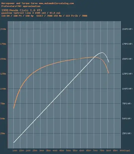

Probably the best way to directly measure the effect on performance of the engine before "X" and after "X" is before-and-after dyno runs (more realistically a rolling road then a bench dyno for obvious reasons). If you've got a before plot then try and recreate the circumstances as much as possible (same dyno, same weather conditions) and compare. If you don't have that then you can always compare to a stock plot if you can find one - but this is going to be less useful since you don't know how much your car differed from stock in the first place.
Assuming this your Civic VTi then according to Automobile Catalog the stock plot should look something like this:
Stock Civic Vti
A major loss vs stock indicate something was wrong with your particular car but not with sufficient certainty to pin it to the low oil running.
