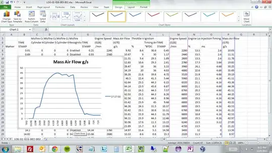

I have a 2002 Audi A4 Quattro 3.0. I have a Vagcom USB cable and I am trying to diagnose the MAF sensor. I had a friend get some readings from an OBD2 scanner, which indicated that both precat O2 sensors (passenger side and driver side) had negative values. He said that it probably isn't the O2 sensors, since both of them are reading similar readings. He also said it is possibly the MAF sensor or a vacuum leak somewhere.
I have taken these readings from the MAF sensor. It appears that the "grams per second" is not going above 50, even when the engine is revving at 7000 rpm.
Does this indicate that the MAF is faulty? Is there anything else I can do to see if this really is the problem?

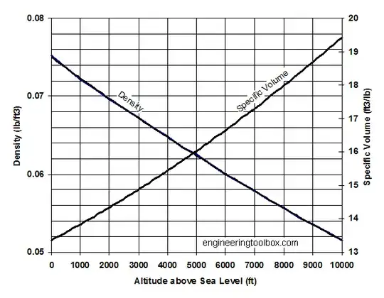

The 50 g/s max flow reading that you are getting is far lower than what merely altitude can explain. enter image description here
The chart above shows that at about 5,200 ft above sea level, the density of air is 83% of what it is at sea level (0.062 lb/cu.ft vs. .075 lb/cu.ft).
So to account for the altitude, you should multiply your expected mass flow by 0.83. According to the VAG-COM diagnosis guide, which I have no reason to doubt, a 200bhp naturally-aspirated engine should flow about 160g/s of air at full-throttle peak power when at sea level. Therefore, at 5,200 ft above sea level, it should flow 160 g/s * 0.83 = 133 g/s. You're seeing 50 g/s.
You're certianly not metering enough air through the MAF. This could be a MAF failure, or a big leak after the MAF.
