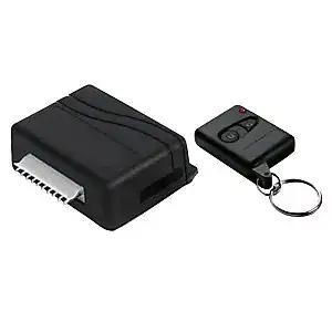

If the vehicle has power door locks it's not a big deal. You can use a system like the one below.
It's currently $35 from JC Whitney

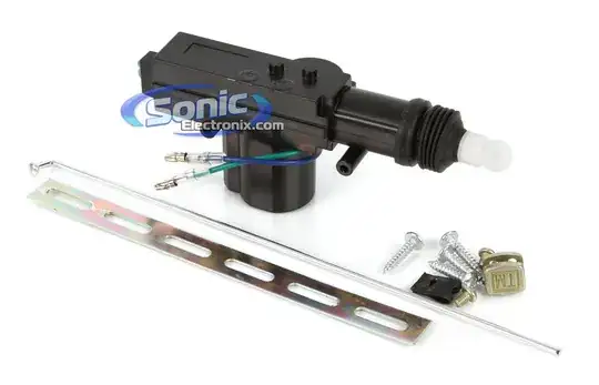

If you don't have factory power locks it gets more complicated. You will need to install door lock actuators, either aftermarket or factory. You could get the actuators, linkages and such from a junk yard, sometimes easier than making the universal ones work. Here is an example of the universal kits
Available from SonicElectronix.com for $8
You'll need one for each door and will have to wire them all together correctly.
