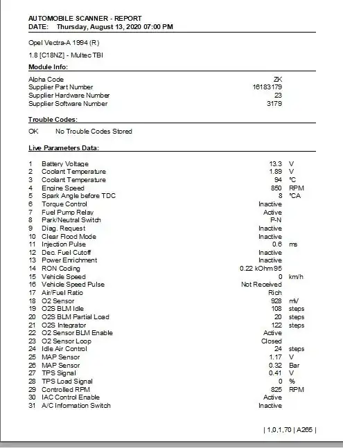

What I'm seeing with the 02 sensor, and the resultant air/fuel ratio is a pulse but the pulse looks a bit jaggy in parts, and also the cycle doesn't seem equal. All the tests were done with the vehicle stationary.
02 sensor 15 mins after operating temp reached
Air/Fule ratio
Note the AF ratio is taken at a different time frame than the 02 sensor.
Can anyone with experience in reading these sensors tell if this look normal or not?
Edit - attach print out data at operating temp.

I've now changed 02 sensor and things seem a lot better driveability wise and also looking at the traces for 02 and AF ratio. As shown below in before and after shots:
Before 02 Sensor Change
After 02 sensor change
AF Ratio before 02 sensor change
AF Ratio After 02 sensor change
Andrew
