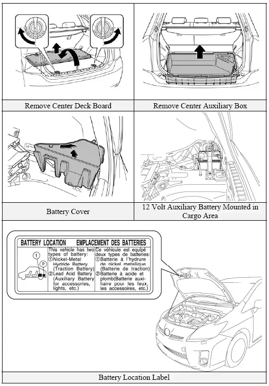

According to 2010 Prius Emergency Response Guide (page 10):
Being electronic, the gearshift selector and the park systems depend on the low voltage 12 Volt auxiliary battery for power. If the 12 Volt auxiliary battery is discharged or disconnected, the vehicle cannot be started and cannot be shifted out of park.
The auxiliary battery is located in the cargo area. It is concealed by a fabric cover on the passenger side rear quarter well (page 15):
access to auxiliary battery
Sounds like you can get to the back of your car and there is no longer a need for you to put it into neutral.
