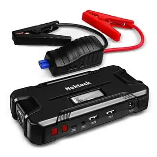

The other week, my friend was trying to jump start a friend's very dead car battery with one of the portable power bank car jump starter kits. It looked something like the below:
portable car jump starter kit
Image source
If I were to have been jumping the dead car with another car, I would have given the dead car's battery a good long charge from the donor car before trying to start it.
I am wondering, can one "charge" a dead battery by leaving one of these portable jump kits connected for like 10 minutes?
Or are these jump kits meant solely to provide a enough juice just for a jump.
