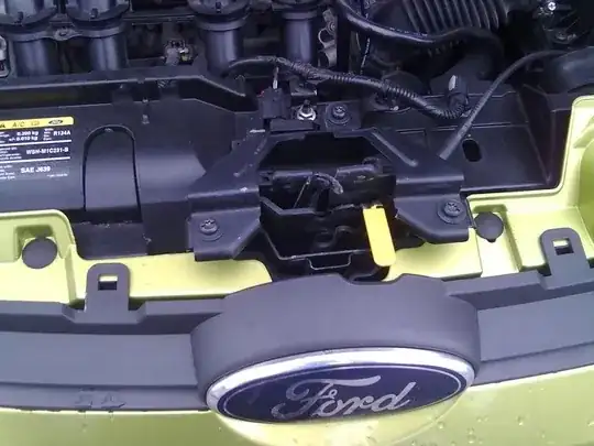

Below is an image from Google, which looks to be the same model as my car, to illustrate what the interior latch mechanism looks like.
Not my car, but this is what the model looks like
