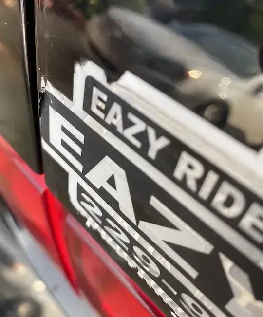

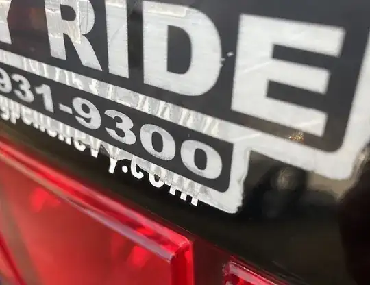

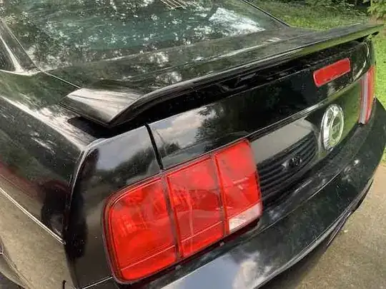

My very lucky teen daughter just got a wonderful honest '08 Mustang GT; the black paint work is fair.
One of the old dealers left this hideous sticker on it:
It's one of "those" stickers - kind of a metallic firm thing.
You can't really, get your fingernail under it. Perhaps just with age, or, I don't know. It really doesn't want to come off.
The dealer I bought it from apparently abandoned hope and just left it there!
(As you can see it was even glued/welded/whatever on top of another dealer sticker! WTH!)
I've previously received incredible get-stuff-off-your-paint work suggestions on here ("dental floss under badges!" "warm with hair dryer!") ...
any thoughts on "those" stickers, that hard/firm sort of metallic super-sticky type?
I guess one specific question is, I've often had success with gunk-off (and similar formulations) with different sticker problems, but I've never tried gunk-off on a vehicle ... Should I try gunk-off or it's no good on vehicles?
Ultimately it just makes me so sick I'll take it to a body shop and have them, you know, repaint the whole car to get it off! Who would do that to an awesome yank muscle car?
But maybe someone on here has an instant suggestion? Cheers

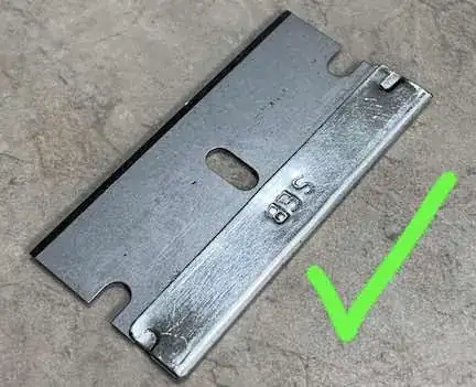

2. Flat, straight, naked, square razor blade
Experimentation suggests this sort of thing will NOT work:
Take off and dispose of the safety device

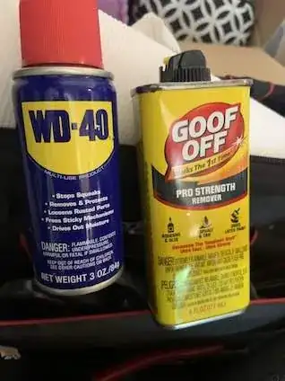

3. Drown it in the magic cocktail of GoofOff and WD40
I tried a number of products on different edges. For me, drowning it in BOTH GoofOff and WD does it.
I simply poured a huge amount of Goofoff on to the surface / some shop towel (WATCH FOR DRIPS) and basically held it there awhile.
(As always with Goofoff, in fact it seems you really do NOT need "a long time", it seems to either work or not; the instructions suggest the same.)
So get the Goofoff in there, and then spray the hell out of it with WD.
Some internet tips suggest putting the chemicals "on the edges". I found that was basically impossible. Just drown it (including the edges). Indeed Goofoff generally softened the damned stickers, rubbed off the pathetic top plastic layers anyway, so it's all good.
Adopt "AS MUCH AS POSSIBLE" approach to the chemicals. Perhaps have a friend continuously spray the WD as you work, even.
Of course take care / test, but I had NO - ZERO damage to the paint from the Goofoff.

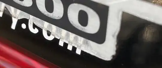

So it worked for me, I just razored a few pieces, then soaked again, razored, soaked.
Razoring:
• It seems you have to hold it so that the tiny edge of the blade is basically perfectly flat to the paint surface
• Just do tiny pieces at a time (see below). Forget the idea of doing a big chunk. I did ~70 pieces
• Incredibly you CAN get it literally "in between" your car and the sticker. It works. The feeling is amazing once you are in there
One mistake and you're screwed. It seems to be something where the outcome is either perfection or total disaster :/
• Forget gloves. If you're sensitive to goof-off, no go. Unless you're like a brain surgeon used to working in surgical gloves, this is going to be an unprotected procedure
• You'll need small fingers since the back of the razor, will only be raised a matter of millimeters above the paint to achieve the angle mentioned
• FORGET the idea that "after getting a start, it will peel off in one big piece". Nonsense! (If it was that easy a sticker, you wouldn't need all this, you'd just get under it with a fingernail then pull.) My one came off in ~70 pieces, I counted.
• It really does NOT work w/ just WD. And it really does NOT work w/ just Goofoff. In my experience. For me and the "EZRideMotors" sticker of death - the combo worked.
