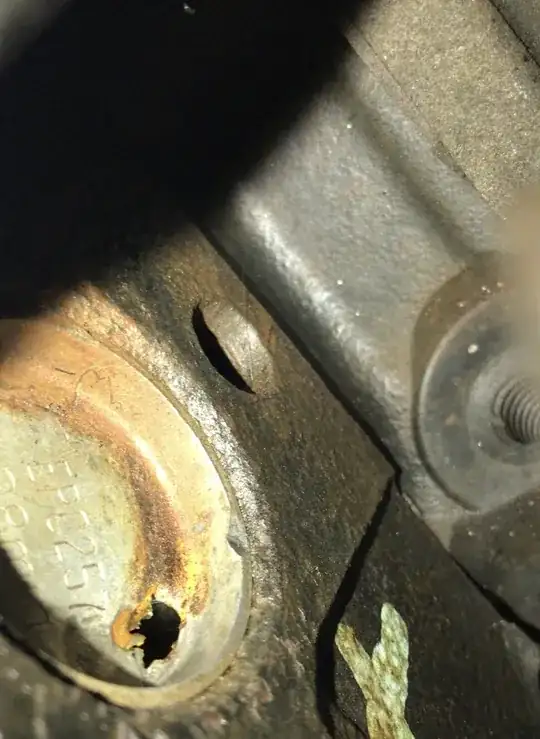

Got a 93 f150 with a 302 5.0 I’m replacing the freeze plug it’s on the back of block on the passenger side I’m using flathead an hammer but it won’t budge it’s in a tight spot is there anything else I can do to make it pop out enter image description here

I would use a pry-bar to get that out, sometimes using a spacer can help change the working angle fortuitously.
I have used a small puller to get them out - a block with a bolt and a "hook" into the plug can also work.
