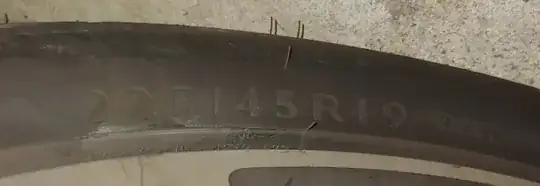

I need to buy two snow chains for my car with the size of 225 45R 19 (Nissan Qashghai 2016),

The 16 or 17 or 18 is the diameter of the wheel.
As the tire has both inner and outer diameters the same, then for the tire to fit the inner diameter of the wheel has to be the same as the outer diameter. So not sure why your source says inner diameter.
See this for an explanation: https://en.m.wikipedia.org/wiki/Tire_code
Note that if you use a snow chain with too small a diameter, then it can foul the brakes or steering components on the inside of the wheel with serious consequences.

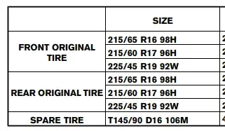

Nissan Qashqai owner's manual suggest you should use the following tire sizes:
It would be best to use these sizes while searching for the right size of your chains. However it is also possible to use tyre calculator (like this one) to compare your tire with ones advertised with a chain. Sizes you've listed are smaller diameter tires than your original one, so chain would be too small.
