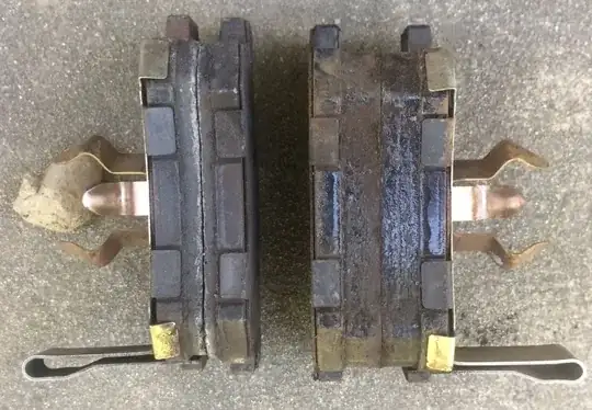

When I started replacing the pads and rotors, I saw that the wheels that didn't smell (both fronts and one rear) all had pretty evenly worn down to 8-9 mm, while the other rear wheel (the one with the smell) had both pads between 4-5 mm. For each pair, the wear was fairly equal for both pads, and that wear was even top to bottom as well.
Rear pads

Due to the even wearing within all pairs, I determined the slider pins were not sticking. On inspection, this was correct. Due to the flat wearing of each pad, I determined that the pads were not frozen within the bracket shims/hardware. On inspection, this was also correct.
