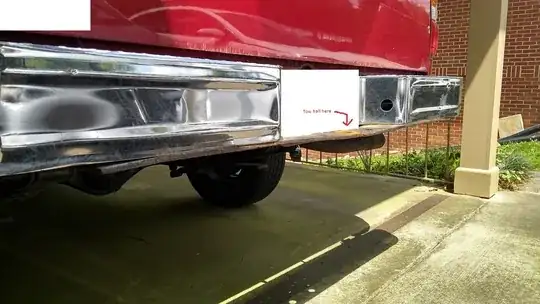

2) Is the tow ball considered a "bumper" tow ball, or considered attached to the frame (see pics below)?
3) Does the structural integrity of my truck look okay for towing?

So when I called Home Depot and described my setup, they said that they wouldn't allow "bumper style" tow balls because they can't guarantee that the bumper is installed properly. But then they said if the tow ball is attached to part of the frame, it should be good. I'm not sure how to distinguish the difference so I took some pictures (I had removed the tow ball):

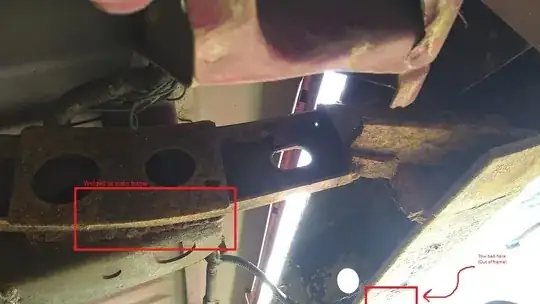

So it looks like the tow ball goes into a steel (?) plate that is a thicker/different material than the bumper itself. This steel plate ultimately is welded into the main frame:
I'm not 100% sure if this is the way the truck was built in the factory or if someone did some custom rebuilding (I purchased the truck used). I'm also not sure if the "dirty" look on everything means that the structure is compromised, or if this is normal.

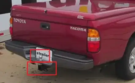

The next thing I noticed when googling around is that you can get a hitch receiver kit for this truck:
It's unclear to me why you'd want to install a receiver hitch when you already have a tow ball. One thing I can think of is that the hitch receiver/ball will sit a little bit closer to the ground. Not sure if that's a desirable thing or a required thing or what.

  2. I do not see any sign of weld on your bumper. It looks a bit rusty, but okay, nothing I wouldn't expect to see on an '01.

That big rusty steel plate that is below your chrome bumper is a modification. Someone wanted a stronger point to mount the hitch ball (stronger than the factory hole in the bumper, which is visible in your last picture) and welded 'er up. The "clean" way to do this would have been to install an approved hitch receiver (as also illustrated in your last picture).
Technically, it appears that the homemade hitch ball plate is indeed "attached to the frame" of the truck; however, it would be difficult to estimate or attest to the strength/capacity of it. Personally, I would have zero apprehension if towing a trailer that small. The question is whether or not the rental entity will allow it...
