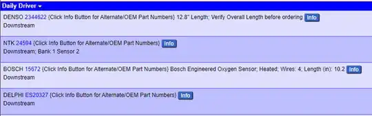

The greatest resource I've found for what you are talking about is a website called RockAuto.com
(NOTE: I have no affiliation with or interest in the website or the company listed.)
Yes, they sell parts, but they have a lot more information than that available on their website.
Here's what I do ...
I go to their website and look up the vehicle in question (whether mine or someone else's I may be working on, whatever.) Once there, I find the part in question. Let's use your vehicle as an example.
Once I've found the vehicle, I find the part.
You'll notice the website has four O2 sensors. Each one listed has in parens the phrase Click Info Button for Alternate/OEM Part Numbers. So, click on the Info button and lets see what happens.
Here is a list of all the part numbers associated with your downstream O2 sensor. You can then take these numbers and cross-reference them using Google or your favorite search engine. You'll most likely want to put something like "O2 Sensor" along with the number, or maybe your car information (ie: 2008 Toyota Camry Hybrid <sensor part number>).
This may not always work, however, I'd give it in the neighborhood of 90+% of the time looking on here provides me with a part number I can use. Once you have the part number, you can use it to find your part at the best price possible.
