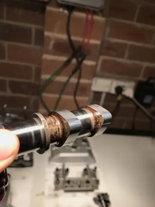

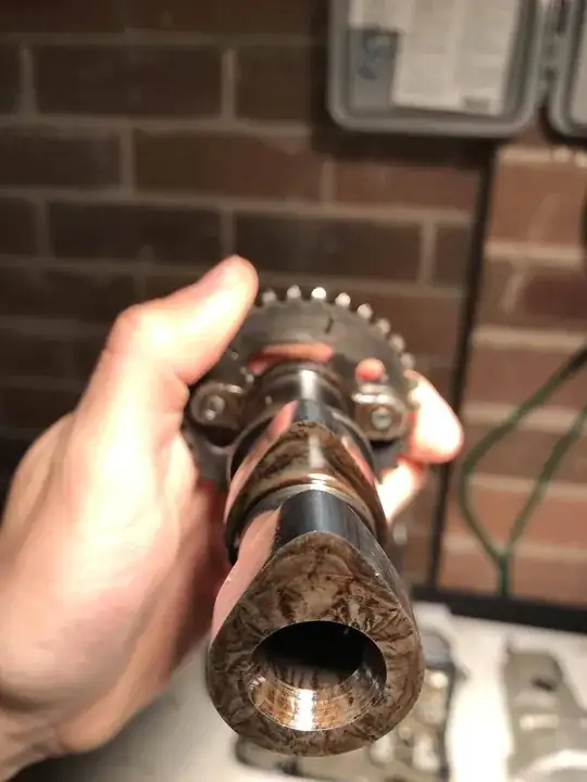

While there is evidence of wear on the intake cam, there is no excessive rounding of the lobes. The intake valves look more recessed than the exhaust valves (see link for photo), however, that seems pretty meaningless to me in the context of the noises coming from the engine. (thoughts??)
enter image description hereenter image description hereenter image description here
After reading some forums, I am now aware that early 2000's kawasakis had inherent problems with their automatic chain tensioners sticking and not tensioning the chain properly, but the chain seemed very tight to me when I took off the valve cover and checked it.

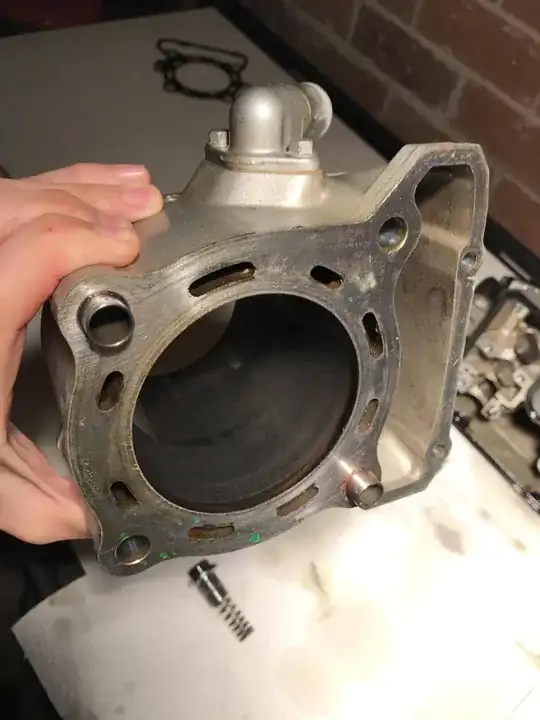

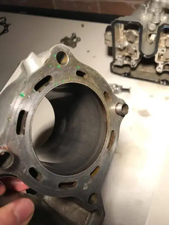

In addition to the above, the cylinder has no aggresive/irregular wear on it, and as far as I can tell, there is no axial play on the piston or rod. I've never rebuilt an engine, however, I am aware that there is a service limit to lateral play between the rod and crank; and in my case, it does seem to be wider than any feeler gauge would be (I will check this). (thoughts??)
