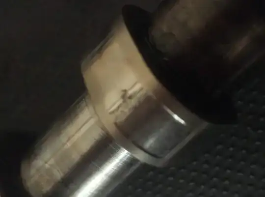

However the intake camshaft had several issues. As seen from the linked images, the camshaft journals and the "bearings" part (well technically this doesn't have seperate bearings, but I'm unsure of what else to call it) are scratched in the valve cover. And the nose of the two lobes of cylinder one (closest to the timing belt) had quite a flat spot:
camshaft lobe with flat spot

Turns out that it was not the camshaft, but more a destroyed con rod bearing on the crankshaft. This however most likely lead to the issues I initially saw at the camshaft...
I really should have started by checking the oil filter, but I guess I just hoped for it to be a simple issue and thus a hydraulic lifter. Anyways this is how the filter looked like, after pressing out all the oil in a vise:
Since I saw that the camshaft didn't have any bearings (this was a new for me), I immediately thought of the crankshaft, and most likely a bad con rod bearing. And I was right.
After pulling the oil pan, I was able to move one of the con rod's side to side with a gentle touch of a finger (see video):
https://photos.app.goo.gl/837rxqRSaQ4B4B477
After removing the rod cap, and the bearing, the crankshaft journals was showing severe scratches
And the bearing was obviously not looking too well. However it is the first time I have experienced the bearing being sqeesed to such an extend that it has gotten wider, kind of funny (See the full album for more images).
