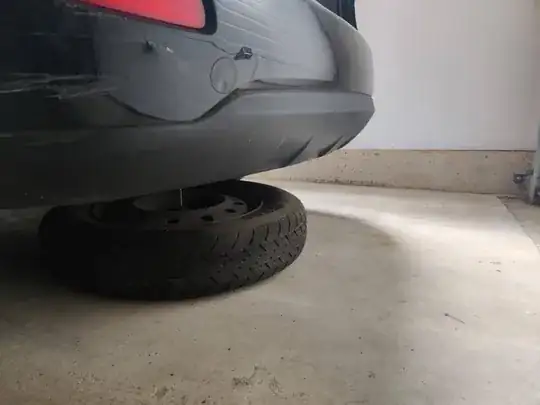

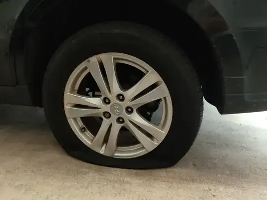

I got a flat tire on my Hyundai Santa Fe 2012 Limited. I am no way a mechanical but still wondering if I can change a tire by myself.
I looked up a few videos online and they just teach you how to change a spare tire. My understanding is that then we still have to take the car to a car shop for a replacement of a regular tire.
My question is though, can I, a newbie, just change a regular tire from my garage, saving time, a few bucks, a trip and duplicated efforts? Is there any difference from replacing a spare tire or any additional work beside the replacement?

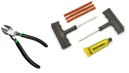

Alternately, you can possibly DIY. If you have a portable inflator and some tyre plugs you can try to locate the source of the flat yourself with a spray bottle of soapy (dish soap works great) water. If you find an isolated nail, use side-cutter pliers to remove the nail then the tyre plug rasp to rough up the hole and finally install the plug and snip any excess off. Some people don't trust tyre plugs but I've never had any problem with them and since the tyre is never removed from the rim there is no need to rebalance.
   Side-cutter pliers and a tyre plug repair kit
