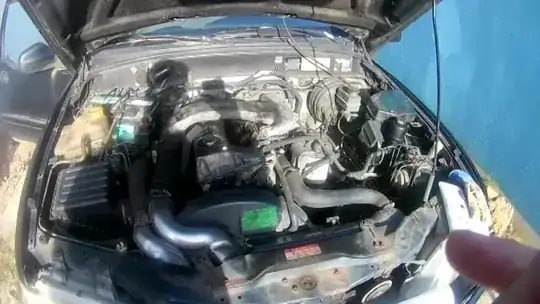

I bought my first project car dirt cheap it's a Daewoo (Ssangyong) Musso Diesel SUV which has one of the most reliable engines, the Mercedes OM602
This car is starting fine but the Engine is shaking heavily
Video
The previous owner (horse farmer) stated it worked fine until one day when he was driving it, the engine started shaking in lower RPMs and since he basically put it right up on craigslist without doing any diagnostics. He also gave me a second (identical) engine and transmission of a second Musso he guttet.
He thinks the fuel intake or valves are shut.

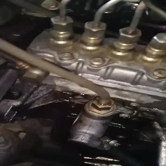

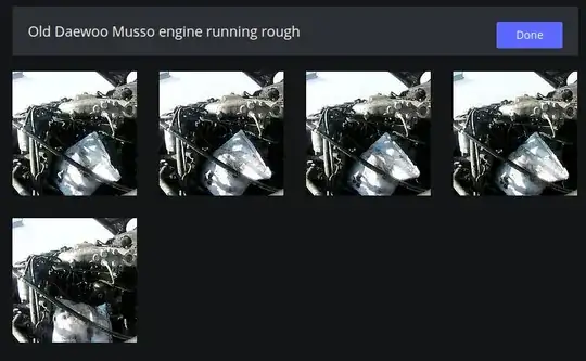

So I disconnected the fuel lines one by one and took a video each. My idea was that if the engine runs worse on one line, it must have been a good valve/injection. But the opposite happened: While disconnecting fuel injection line #5, the engine ran a bit smoother but not by much.
Videos with sound be found here:
Each fuel intake disconnected

It's the 5th cylinder or valve that causes the heavy shaking and I should change it and it might work again.
Engine But the engine looks very good, is well oiled and doesn I can't see any top damage on the valves
