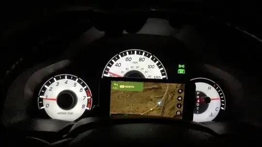

Here’s a still image from a video I took while this was happening.
dashboard during mysterious acceleration
My foot was still off the accelerator (not that it should have mattered at this point).
Again, the acceleration was slow. The RPM’s were just below 1,000, so only slightly higher than when idling.

Off hand, I'd have to blame this on using non-adaptive cruise control in snow when driving uphill. Even with the chains on the front (and assuming front wheel 2WD), the cruise sensors could be misinterpreting wheel spin vs. ground speed. With 4WD and chains only on the front, I've got to imagine that this discrepancy would be more pronounced. Perhaps the addition of chains on the front wheels have created a significant difference in the two front wheel circumferences and traction control thinks one or both of your tires are spinning.
Do not use cruise control.
For some, driving with cruise control has become almost second nature. Sure, it prevents you from getting leg fatigue, keeps you from unwittingly speeding and is great on long trips, but driving with it on in winter conditions can be unsafe. Thus, if cruise control has become a staple of your driving habits, make a conscious effort to ensure that you are not using it in winter weather.
Using cruise control in the snow, ice or even rain is dangerous because if your car hydroplanes or skids, it will accelerate and rapidly spin the wheels since it will be trying to maintain a constant speed. If this happens, it will be more likely that you lose control of your vehicle.
source: 5 key steps to staying safe in winter driving
So a combination of cruise control, traction control and driving uphill in snow is confusing the system causing cruise control to 'accelerate' to maintain what it thinks is a slowing vehicle in low traction conditions.
