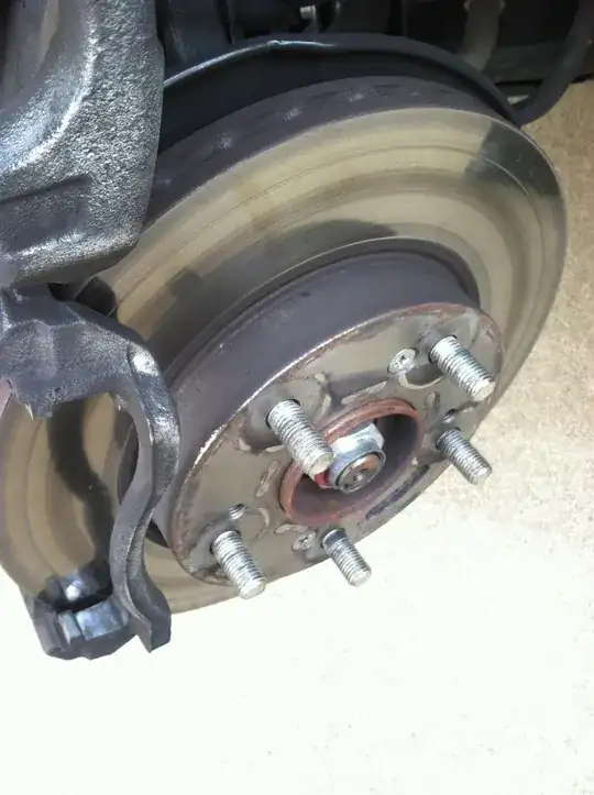

  • The outer side of my driver's side rotor has an apparent groove on it:
    Rotor groove

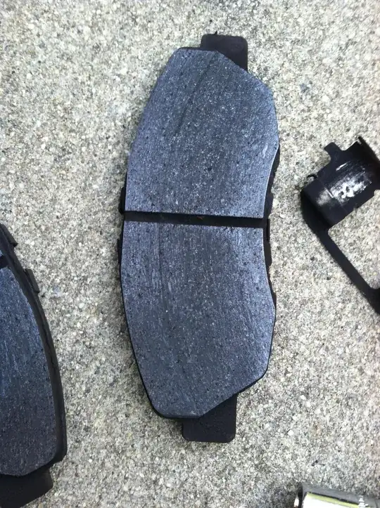

    The corresponding brake pad has a matching groove:
    Pad groove
    However, if this groove was the cause of the noise, wouldn't the noise happen every time I brake?
