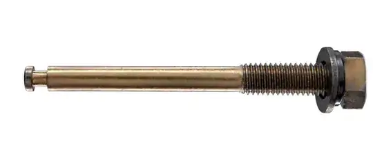

The pin looks like this:

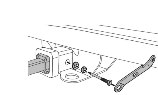

And it screws in here:

As long as you wish and the threads don't get damaged.
I have a hitch like that, over 15 years old.
Do Not lube it, this attracts dirt and grime which will wear it out faster than normal dry use. You can lightly lube the threads with anti-seize paste.
