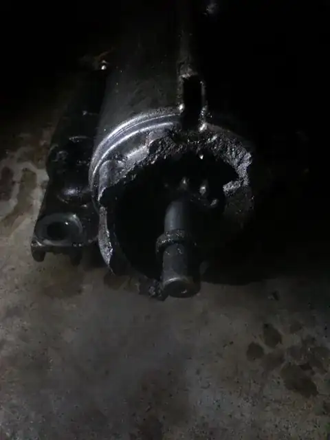

What you see here is what remains of my starter. I think it's safe to say that I need a new one.
