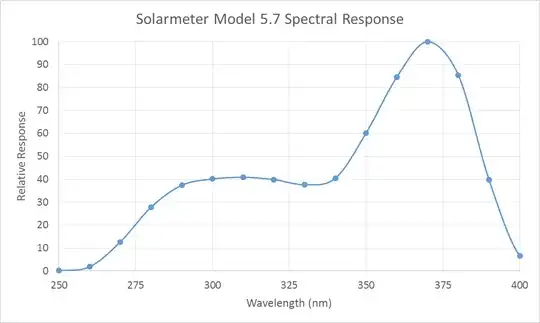

I tested the level of UV protection myself with a Solarmeter® Model 5.7 Sensitive UVA+B Meter. I am aware that glass protects against >99% of UV-B radiations, so the usefulness of adding tint to a window from a UV mostly comes from reducing UV-A radiations.

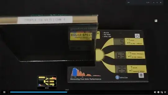

Another meter to quantify the level of UV protection of a film: EDTM SS2450 Solar Spectrum Meter (more convenient as no need to go under the sun)
