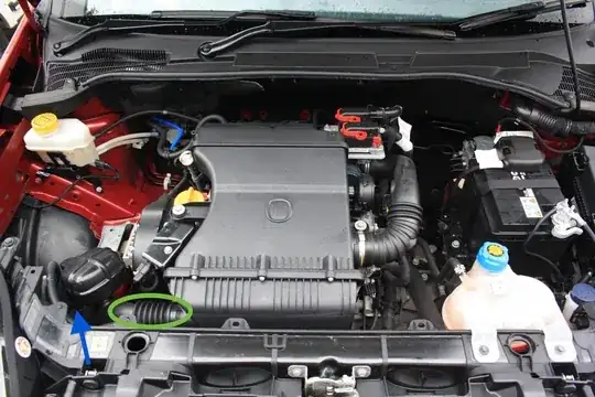

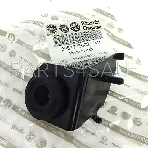

I found the issue, after a lot of searching through the fiatforum.com and by chance came across a suggestion it could be the intake pipe leading to the airbox, which is mounted to the chassis via a metal bracket with a rubber bushing. The bushing was worn so the plastic intake was rattling around a bit. This made a hollow rattling noise, which I mistook for the exhaust as it increase under acceleration (increased vibration through the engine, and therefore the plastic intake rattled more)
I replaced the mounting and the noise went away. You can also zip-tie the intake pipe to the bracket to reduce the vibration but this makes taking the airbox off more difficult (have to cut the zip tie every time and replace)
Plastic pipe where the noise eminates from is circled in green, place where the bracked joins pipe to chassis is arrow in blueenter image description here
