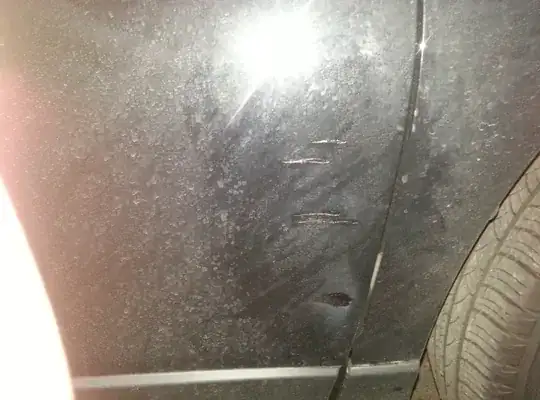

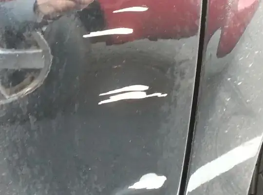

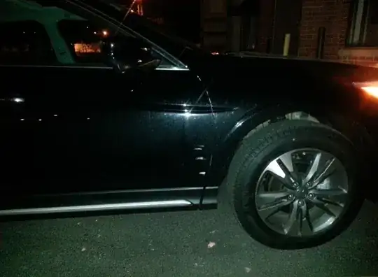

Got a Black, Crystal Black Pearl, Crosstour. Just last night, I reckleslly backed into the parking lot, and front right door was scratched by the short stone wall adjacent to the spot.
I'm not cheap, but is it worth getting a new door or is there a more recommended solution?
Update
Just now found this one website that claims to sell the right color "NH731P" for it, if not roughly the same. Then searched it on amazon if it's a universal color. So I found this product. Would you recommend it? Never used touch paint before, would I need sandpaper and other tools?
More pictures with better Exposure
Closer Look enter image description here
Biggest Scratch (The bottom one) enter image description here

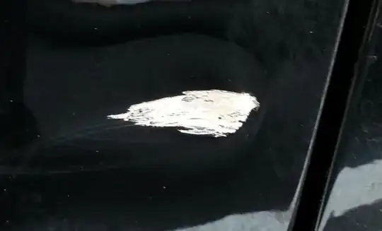

After Applying Touch Paint
Up Very Close
Up Close

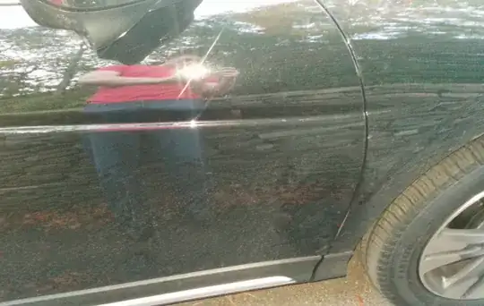

From standing

You should try buffing the door first to ensure what you see is not just transfer from the stone. Some of the top layer paint might be missing but you also might have some of the stone on the car and that might be what you are seeing here. Pearl is extremely difficult to repair, but good thing is that being on the door and somewhat lower than the top of the door, any touch-up you do will not stand out too badly.
William Gray
  • 126
Yikes. Your problem is that pearl is a doozie to match by a paint shop and it's almost impossible for non-professionals to do a localised repair on it. Best case is that you can take it to a body shop and they'll end up sanding down and respraying the entire door. If you can live with it, you may be able to apply a scratch repair product which will make the paint dissolve a tiny bit, covering up the exposed metal. You'll need to also apply a layer of clear coat. McGuiars sells an all-on-one scratch kit. It's not gonna look as good as a proper respray, but it will cost 10 times less.
As I said, your problem is that pearl is very difficult to repair.
