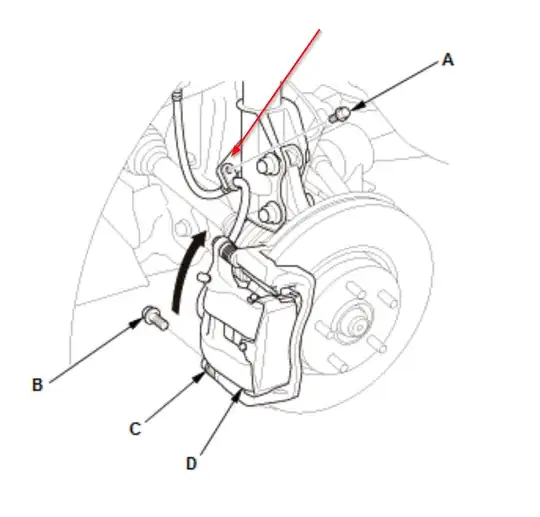

I had four tiny corner welds on a nut fail removing the below bolt, irritating but not really a problem, just put the nut back with a lockwasher, but it would have been nice to prevent it. I could have hit it with PB Blaster and let it soak, but the failure torque seemed to be very slight.
