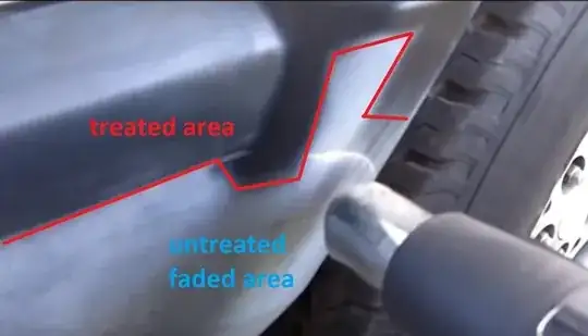

Faded Plastics back to black with a Heat Gun [link]
This fella uses a wagner heat gun he bought for $20 and mentions the process running 10-15 minutes. Says the pigments of the plastic rise up to the faded pieces. Claims the fix lasts at least a month from his last update.
There was an interesting comment left on this video which explains:
when the sun heats the plastic, it attracts moisture from the air; as the plastic cools, the moisture gets trapped in the closed cells. It shows up as a cloudy grey on the bumper. The heat gun opens up the cells and allows the moisture to escape. Tougher areas means deeper trapped moisture. This technique will also work on tea-cup stains on varnished pianos...coffee tables etc.

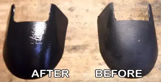

before and after from heat gun treatment

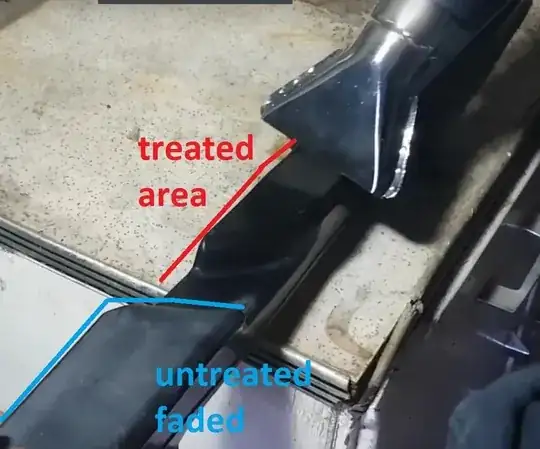

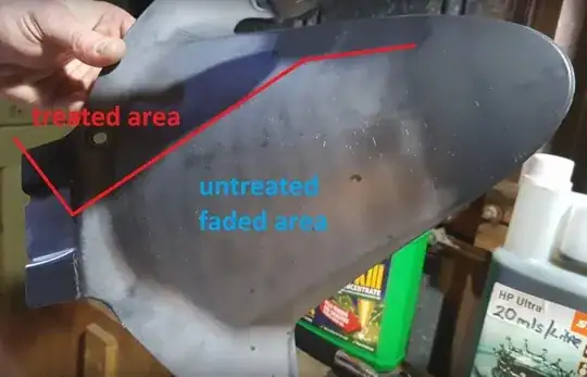

How to Restore Faded Plastic/Trim | Easy - Automotive | Amazing Results | Heat Gun [link]
Treats a few body parts for his motorcycle. treated and untreated motorcycle body part treated and untreated motorcycle body part

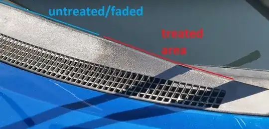

Heating plastics to bring back BLACK [link]
Restores the plastic parts at the top of the car hood/bottom of the windshield. Claims process works by "bringing up the natural oils" of the plastic to restore its color. Follows up heat treatment with automatic transmission oil to restore shine.
treated and untreated windshield wiper hood plastic

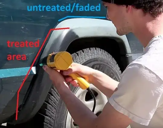

Restoring Jeep Cherokee Fender Flares with a Heat gun [link]
Mentions using heat gun on high setting. Gives warning when working near the gas cap. faded unfaded Jeep Cherokee fender flare
