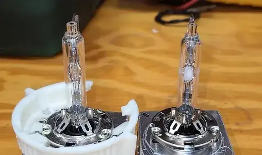

I actually measured decreased light output from a 5 year old Phillips D3S HID lamp compared to a new HID lamp of the same make and part number. Using a Foot-Candle light meter I measured the "Bright Center spot" of the new and old HID lamps from 10 feet away. The highest Foot-Candle readings were: 200 FC for the 5 year old lamp and 500 FC for the new lamp. New lamp on left, old cloudy lamp on right
TomB
