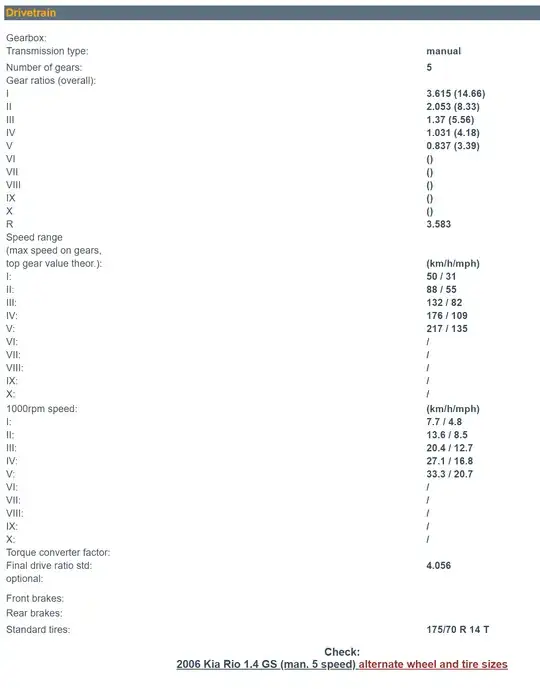

The specs for this vehicle show that it has a 5-speed manual and that 5th gear is OD/Overdrive. According to the performance data here:
Kia Rio Gear Ratios
The following table from that page lists the speed at 1000 rpm for each gear:
1000rpm speed:     (km/h/mph)
I:                  7.7 / 4.8
II:                13.6 / 8.5
III:              20.4 / 12.7
IV:               27.1 / 16.8
V:                33.3 / 20.7
So in 5th gear the you should get 20.7 mph in 5th gear at 1000 rpm. Scaling this to 65 mph (multiplying both values by 3.14 or the ratio of 65 mph/20.7 mph) gives a predicted rpm of 3140. That's in line with what you read as 3300 rpm.
So yes, that seems to be the normal rpm at 65 mph. Your rpm could be a bit high due to an inaccurate speedometer or tires a size or two smaller than the tires on the test car.
That engine speed does not seem unusually high for such a car.
