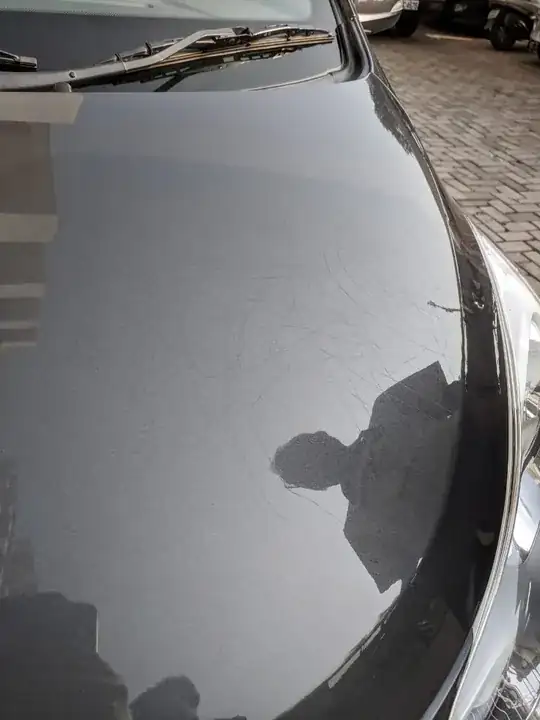

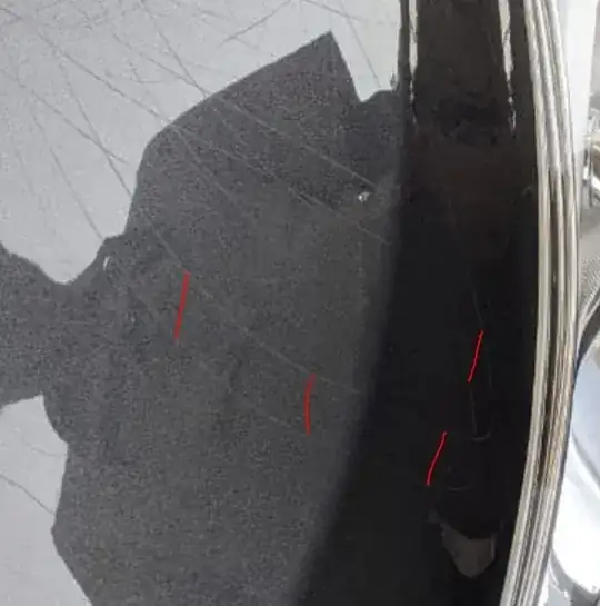

![engine hood Engine hood has scatches as shown in pic. I suspecy cat scratch, i need your commet on this as per pattern of scatcjenter image description here
There's a number of these scratches that run parallel for some distance, and around bends, so this isn't the work of a cat. I'd guess that someone has tried to wipe the surface with a rag or sponge with some specks of abrasive material embedded.
Phil G
  • 1,087
I will have to agree with the other answer and say that I don't think this was done by a cat. It's hard to tell exactly what did it, but there's a few reasons I don't believe it's a cat.
  1. The scratches are too long and parallel as @Phil G pointed out. Cat's generally don't scratch things in this way and their claws are not perfectly parallel.
  2. A cat wouldn't really have a reason to scratch your car. The metal/paint would more than likely irritate their claws. Why use a car when there are (I'm assuming) many trees that would work better as a "scratching post" for them?
  3. The location of the scratches on the car further points to the fact that it wouldn't be something a cat would be interested in. What exactly would they be clawing at at that location on your car? If it was on the sides where it could have been claw marks from climbing up, it makes more sense.
Overall, I would say it's unlikely that this was done by a cat. Only you would have a good idea at who the next suspect would be so I'll leave that up to you
Matt
  • 153
Given the position of the scratches on the bonnet, I would suggest that they are likely caused by someone (human) sitting on it. As Phil G says, the pairs of parallel scratches are too far apart to be cat claws (which would be four closely spaced lines, around 4-5mm apart).
