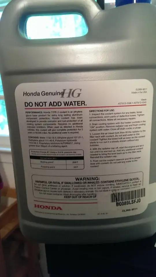

The Honda coolant is 50/50 prediluted, non-silicate/non-borate, type 2 ethylene glycol based coolant (I know this because I just snagged a bottle out of my basement and copied that off the back label, shown below).
Honda Genuine coolant label
